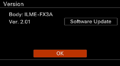

    1. Select MenuSetupSetup OptionVersionBody.
    2. The system software version will be displayed.

    2. Select MenuSetupSetup OptionVersionBody.
    3. Select Software Update.

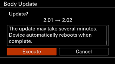

    4. Select Execute on the system software update confirmation screen. The software version update will start.
      On-screen message:
      • Update? X.XX → Y.YY

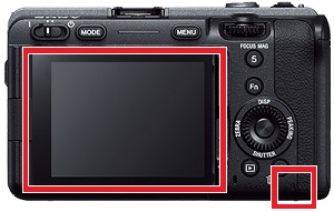

    5. When the system software update starts, a black screen will appear. The access lamp will flash 1 time3 times5 times depending on the progress. the update will take approximately 6 minutes to complete.
      The access lamp is located under the right side of the camera when the Rear side of the camera is facing you.

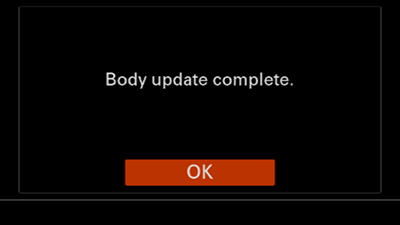

    6. When the update is complete, the camera will automatically restart. After restarting, press OK on the “Body update complete” screen.
